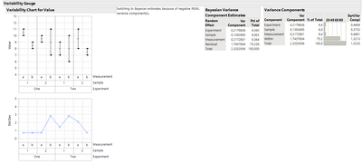

I'm trying to find where the error is coming from in my experiments.  But I have multiple points where errors can occur.  Is there a way to determine which part of my experiment is responsible for the most error?  I have attached an example which has three sources of error:  Experiment, sample and measurement.  All of these contribute to the differences in the value I receive.  I'm hoping for an explanation or maybe a script on how I can set up an analysis looking at the source of error.  Thank you.

Dear @wyler0 ,
I'm not sure whether I interprete your data right,
you have 16 measurements,
done with
  • 2 samples,
  • 2 experiments
  • 2 measurements
  • and 2 repititions
and you expect the same value for each?
May be you want to have a look at the variability platform, with variance components, see screenshot.
It looks that your repeatability is very poor, it accounts for 75 % of the variations.
See the manual and script for the analysis attached:
Variance Components (jmp.com)
So you have to find other sources or a suitable measurement first.

Thank you Georg, this is exactly what I was looking for.
