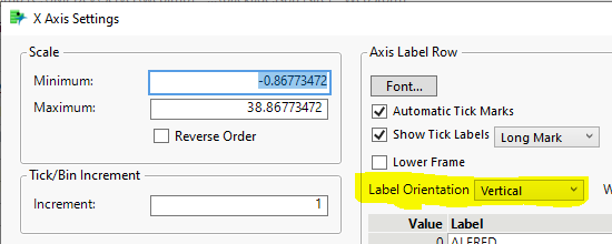

It's hard to tell without a picture or script to reproduce what you are seeing, but my guess is that it could be caused by the web version of the axis being more aggressive about removing axis labels that might overlap.
One thing that might help is specifying the Label Orientation on the x axis to be Vertical.
Here's what that would look like for a column chart of students' heights in Big Class.jmp exported as Interactive HTML.
