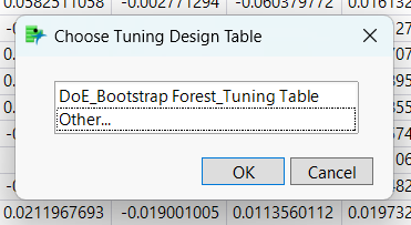

I'm running bootstrap forest as a predicative model. I have hyperparameters I like but want to run multiple times (ex. 500 replicates) to find the random forest that gives me the best validation r square. I have the tuning design table built, but every time it runs for one predicted y-variable (there are 11 in my dataset) I have to manually choose the same design table every time. It's time consuming to sit by the computer and wait 10-15 minutes for each run and then click the next. I'd much rather set it and forget it. Is there a setting so that it can run the same tuning table for each y-variable automatically?
For reference this is the box that I'm having to click after each bootstrap forest is complete:

According to the Documentation on Bootstrap Forest, you should just specify the table to use in the JSL for the platform.
i.e.
Bootstrap Forest(
	Y( :Percent body fat ),
	X(
		:"Age (years)"n, :"Weight (lbs)"n, :"Height (inches)"n,
		:"Neck circumference (cm)"n, :"Chest circumference (cm)"n,
		:"Abdomen circumference (cm)"n, :"Hip circumference (cm)"n,
		:"Thigh circumference (cm)"n, :"Knee circumference (cm)"n,
		:"Ankle circumference (cm)"n, :"Biceps (extended) circumference (cm)"n,
		:"Forearm circumference (cm)"n, :"Wrist circumference (cm)"n
	Tuning Design Table("place your design table name here"),
	Go
