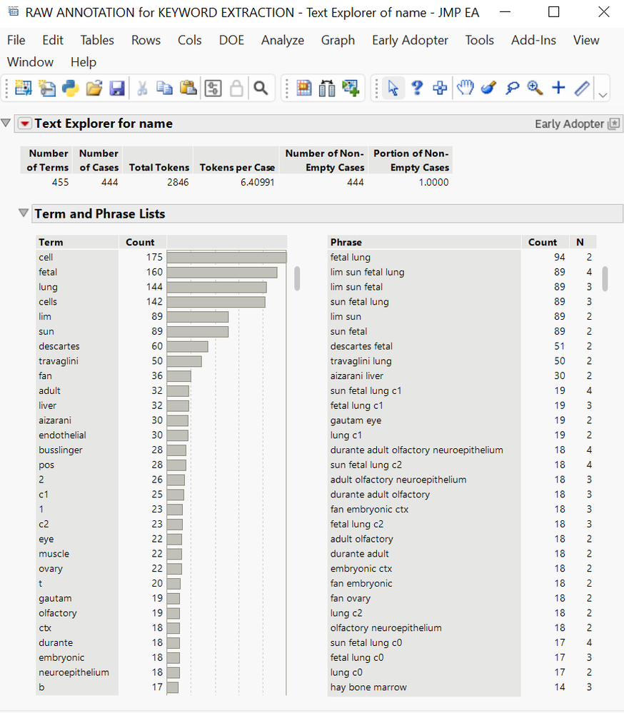

Since there are > 400 rows/annotations, I am looking for a semi-automated method that would be faster than a manual RECODE.
Note: I wonder if TEXT EXPLORER could help here.

I made a custom regex to turn the underscores into word delimiters (edited to add comment):
Text Explorer(
	Text Columns( :name ),
	Set Regex(
		Custom(
			Title( "underscore" ),
			Example( "x_rr_tttt_yyy" ),
			Regex( "\[([^_]+)]\" ),
			Result( "\[\1]\" ),
			Comment( "tokens (words?) separated by underscores" ),
			Locale( "" ),
			ColorStyle( 10 )
	Customize Regex( 0 ),
	Language( "English" )
and got a report like this
Craige
