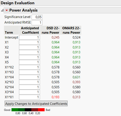

In their example and demonstration, for an equivalent number of runs than DSDs (22), OMARS may have better projection properties and larger power for quadratic effects, and able to fit all 2-factors interactions. You can reproduce their comparison using the OMARS Designs Add-In  and comparing an OMARS design with a DSD design using the plateform Compare Designs
I attached the designs table to make the comparison easier if you want to have a look.
  • You can check that OMARS may be able to fit more terms (all interactions and more quadratic effects than DSD), and power for interactions and quadratic effects are equivalent or higher (for the cost of a small power decrease for main effects) :

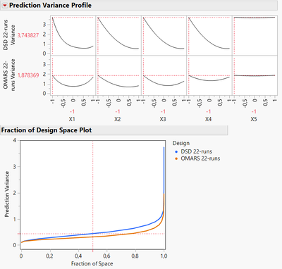

  • They also have lower maximum prediction variance and lower Fraction of Design Space Plot curve (so lower prediction variance over the entire experimental space) :

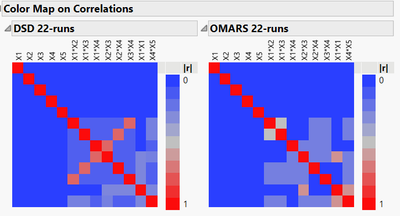

  • The Correlation Map is also interesting to compare, with lower correlations between terms :

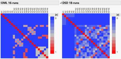

    Comparison of correlation map between OML and DSD created for 2 two-levels categorical factors and 4 continuous factors :
    You can see that in the case of DSD, you have small correlations between main effects of categorical factors and the other main effects. With OML, you have a structure that enable to have no correlation between main effects and between main effects and 2nd order terms. OML also enable to have other/different design size than DSDs.

Hi Victor, comparing OML & DSD what about the correlations of the 4 quadratic effects? From the correlation tables above I would prefer the DSD: correlation between some main efects is véry low and negigible and each interaction effect is correlated with only 1 other interaction effect. Correlation structure of OML interactions is quite complex; think in OML algorithm there is too hard push to get zero correlation between main efffects resulting in more comlex correlation between interactions (?) (there is no free lunch, a price has to be paid..) Achieve zero correlation between main effects too my opnion is not necessary, in lot of unbalanced custom designs and when incuding covariate factors there's always a little correlation among main factors; R < 0,2 is acceptable.
