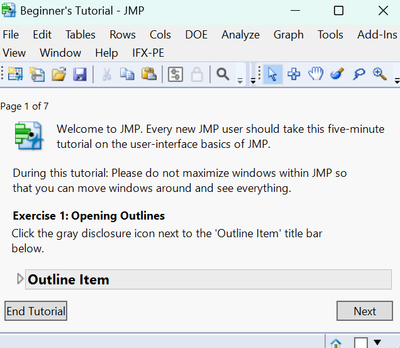

2. Is there any easy interface to design such jounrals(applicaiton builder or any other) instead of scripting long code
or is there any open resources to aceess source code of scripts like JMP beginner tutorial (Help -> Tutorials -> Beginners Tutorial)

1. It might work if you create a zip and store them in same folder
2. You can most likely find the script for beginner tutorial from JMP installation folder. I don't have JMP version older than 18 and it doesn't have that menu item, so I'm not sure where it could be located (I would guess inside \<JMPVERSION>\Resources\Builtins folder).
