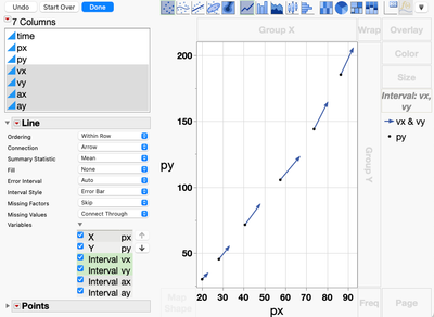

If I drag px -> X, py -> Y, and the rest to Interval, then set the line ordering and connection settings, I get this:
The velocity vectors are drawn, but the accelerations aren't showing up, and nothing changes if I uncheck them from the variables list.  Did that feature get removed/modified?  It's weird that ax and ay don't show up in the Interval box or the legend, but if I right click it they are there and it gives me the option to remove them.

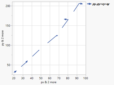

I remember that this option is possible by dragging multiple columns onto the axes.
With the new option ,they will automatically be used in pairs:
To use this mode (instead of Interval) you can calculate the "3" points as transform columns:
Graph Builder(
	Transform Column( "py+vy+ay", Formula( :py + :vy + :ay ) ),
	Transform Column( "py+vy", Formula( :py + :vy ) ),
	Transform Column( "px+vx+ax", Formula( :px + :vx + :ax ) ),
	Transform Column( "px+vx", Formula( :px + :vx ) ),
	Size( 483, 459 ),
	Summary Statistic( "Median" ),
	Variables(
		X( :px ),
		X( :"px+vx"n, Position( 1 ) ),
		X( :"px+vx+ax"n, Position( 1 ) ),
		Y( :py ),
		Y( :"py+vy"n, Position( 1 ) ),
		Y( :"py+vy+ay"n, Position( 1 ) )
	Elements(
		Line(
			X( 1 ),
			X( 2 ),
			X( 3 ),
			Y( 1 ),
			Y( 2 ),
			Y( 3 ),
			Legend( 5 ),
			Ordering( "Within Row" ),
			Connection( "Arrow" ),
			Summary Statistic( "Mean" )
don't know how to distinguish between the 3 segments if all 3 are parallel ...

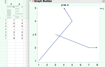

I think @hogi is remembering correctly and that the example used an SAT sample data table where every year had a different pair of columns (math and verbal).
You can also do it with stacked data using missing values or a grouping variable. However, that requires restructuring the data, unlike the transform approach.
Graph Builder(
	Show Control Panel( 0 ),
	Variables( X( :x ), Y( :y ) ),
	Elements(
		Line( X, Y,
			Ordering( "Row Order" ),
			Missing Values( "No Connection" )
