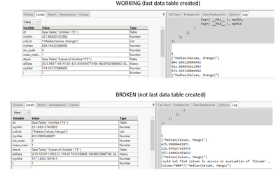

When I run extract_cols.jsl I get 4 new datatables named "Untitled X". Then when I run heatmap.jsl it only is able to create a heat map for the last Untitled X table created. I don't understand why this is... When I look the debugger code it says "could not find column in access or evaluation of 'Column' ". However, I print the column being used "Median(Values, Mango)" and it shows up so I am not sure what is happening (see output picture below).

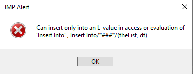

When I run the updated extract_cols script you provided I get the following error message below about L-value access...

my error, change
insert into(theList,dt);
to
insert into(trans:theList,dt);
theList does not exist......but trans:theList does

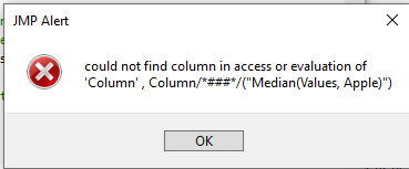

So when I run the heatmap script I get the message below. When I change
 dt= trans:thelist[5]
it works but again only for the last data table created. Also this namespace concept is new to me. Let me try to summarize what this is doing and can you confirm if my understanding is correct? So by using namespace in the script we are able to saving all the data table names (and more importantly the column names and value of that data table) into a list trans which we then call in the heatmap script.
txnelson
Re: Variables not being passed between scripts
If you hover over trans:theList or if you specify
show(trans:theList);
in your script it will show you what is in the list.  What you will see are 5 entries.  The first one will be
Data Table( 'the name of your initial data table");
Each entry after that will be the pointer to the data table filter by, Apple, then Banana, then Mango, and finally Orange.
It does not contain the data, just a pointer to it.  The column names, etc. are retrieved from the actual data table.
