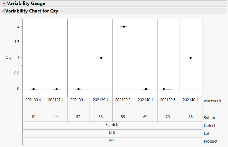

I plot variability chart and want to add line to connect each data point for each group to show the trend.
However, the line cannot be added.
Could you take a look if I missing anything in my code?

I was able to replicate your issue - and what seems to be the issue is that Sublot and Workweek are redundant - if you only use Product-Sublot on the x-axis you can connect means as expected, but as soon as you add workweek that stops.  I know that you cannot connect means across subgroups - so if you had different defect types you would only connect means within each Defect type. So what I think is happening is JMP is treating workweek as a distinct subgroup within Sublot and therefore is unable to connect.
