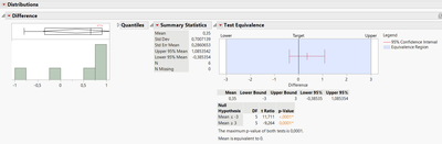

      However, if you want to proceed with this analysis, create a formula column with the difference between the two measures, use the Distribution platform to display the distribution of the Difference column, and from here, you can click on the red triangle and launch an equivalence test with the practical difference of 3 considered as equivalence (and hypothesized mean = 0, confidence level = 0,975 if you want the combined result of the two tests to be displayed at confidence level 0,95). Based on your dataset, here is what you could expect :
      Remember that this equivalence test only test mean difference, so it won't provide information about a difference of variance between the two measuring systems (which might be very informative to highlight a gain in precision for example).

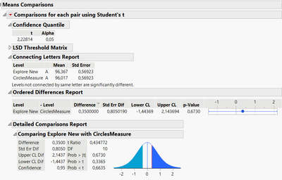

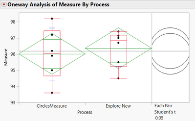

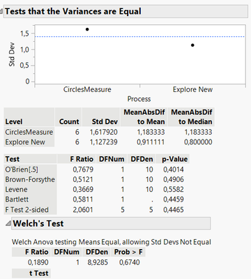

  2. Using your datatable in a stacked format, you could have a different analysis option using the platform Fit Y by X. Using your process as X and measure as Y, you can test difference in means (with Student t-test or non-parametric test, depending on the distribution of your data) as well as equality of variance ("unequal variances") between the two measuring processes using options from the red triangle. Here are the type of informations you can collect :
    Tests for equality of variance (with Welsh test for difference in means):
    T-test for difference in means :
    Also the visualization displayed in this platform might be sufficient to understand if your results are comparable, in terms of means and variance :

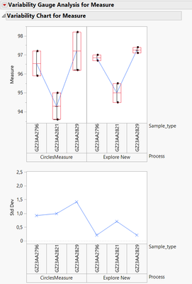

  3. You could also use the Measurement Systems Analysis platform to compare the two processes and see how consistents are the results. The visualizations available in this platform are quite helpful to compare the two processes :

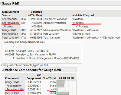

    Using the Gauge R&R evaluation, you can see (with the small dataset provided) that you may have more variance due to the repeatability than due to a change of measuring process :
