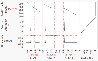

I think the solution here is to define a custom desirability function as a formula column.
In the attached example using the Tiretread data I created a custom desirability function for ELONG which is 1 for the range 450 to 550 and 0 outside of that range.
If( 450 < :Pred Formula ELONG < 550,
	1,
	0
Then we profile the prediction formula column for ELONG and the custom desirability function. Set the desirability function for ELONG to none and Maximise for the custom desirability function.
I think that should work. Let me know.
Phil

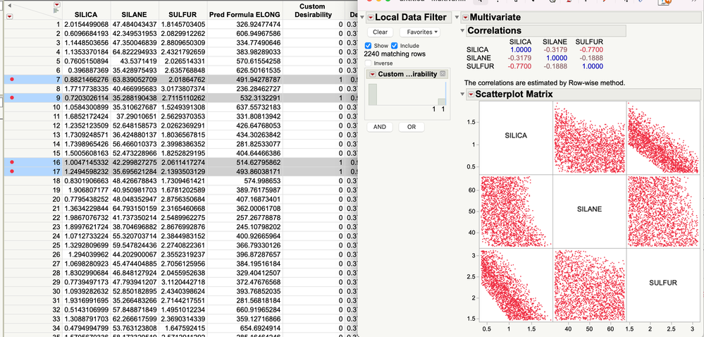

One thing you will need to careful of is that the custom desirability function that @Phil_Kay describes is flat over a range, so there are possibly many optimal solutions (with a maximum desirability).  To visualize factor regions where the desirability is constant and at the maximum, you could consider using the "Output Random Table" command under the Profiler and then make a scatterplot matrix of your factors, and filter that plot on the desirability.
