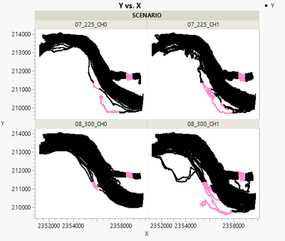

The data are from a particle movement model that I put through a hydrodynamic model (river). I like to plot the path of the particles using coordinates to determine where the particles go in 2D. The paths are broke into 20 second increments of model time so it is essentially a running times series of particles responding to model parameters as they progress through the modeled river system Doing it this way allows me to calculate variables of interest for each particle (time, velocity, etc). I release 500 particles per scenario and let them run through the model (river). The output when plotted with graph builder shows the particles path through the river.
Problem statement: I want to identify the particles that went through off-channel sections of the model space separately so I can compare the entire run length/path of particles that went through off-channel sections to those that stayed out of the off-channels and in the main channel.
I typically use the "Lasso" function to grab the subset of particles I am interested in for analysis, but this time I want find the particles that used the off channel areas and compare them to those that didn't across the entire run of the model. The lasso function constrains the data to just the section highlighted, not the entire run of the model.
Below you will see the lasso function being used to highlight the areas in pink I am calling "off channel". The black in the below are the particles path plotted with their X,Y coordinates every 20 seconds of the model run time.  I want to identify and label the entire run of each particle across the model run, not just the section highlighted so I can separate them from the rest of the particles that stayed in the main section of the river.

Re: Using graph builder to identify data, then making subset of the identified data: unique problem
Is this what you're looking for? It's faster to do than to explain :)
  1. Make sure nothing is selected in data table
  2. Select a portion of one of the off-channels
  3. In the data table, select the Scenario and FID columns
  4. Right-click in the row header space on the left of the data table, select "Select Matching Cells"
  5. Now the entire off-channel subset is selected
Thanks for engaging Jed!
Yes, that seemingly selects all of them.... Doh.... I spent most the night trying to figure that out....
This support page is awesome!!!!!!!!! Look forward to supporting it once I learn the system better.
Thank you so much!
