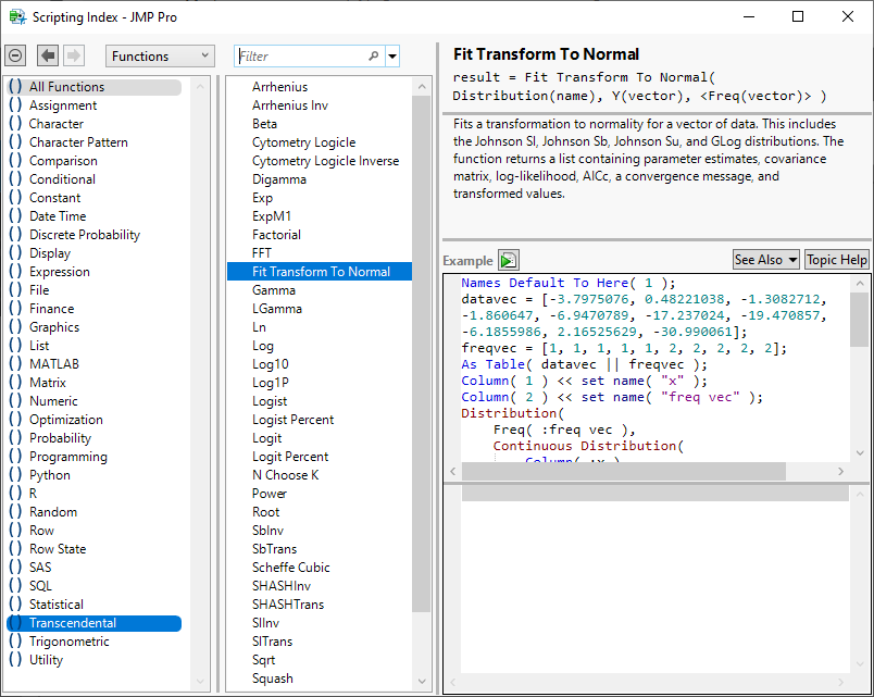

Re: Using Fit Censored for other distributions?
This function is not documented very well. Here is the Help > JSL Syntax Guide entry for it.
This is the same as the Help > Scripting Index entry:
