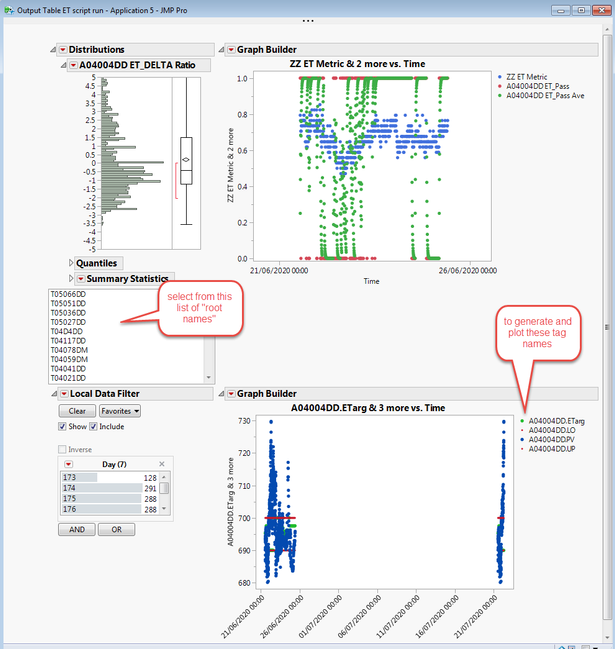

Hi, I'm trying to give the user the ability to choose a tag name, and create a time series plot of multiple variables that have that tag name as their root.
However, I'm struggling on how to dynamically update that.
The list box contains a list of tags , then the variables to be plotted will have that tag name, plus an extension, .PV, .ETARG, etc in this example.
I parse the  following statement to generate the variable names
				vars = {};
					str = "Variables(
		X( :Time ),
		Y( :" || TAG || ".ETARG, Position (1) ),
		Y( :" || TAG || ".LO, Position( 1 ) ),
		Y( :" || TAG || ".PV, Position( 1 ) ),
		Y( :" || TAG || ".UP, Position( 1 ) )
					vars = parse(str);
then the graph builder references these, instead of having fixed tags to plot
Eval Expr(
	DataTable1<<Graph Builder(
						Size( 466, 405 ),
						Show Control Panel( 0 ),
						Fit to Window( "Maintain Aspect Ratio" ),
						Expr(Name Expr(vars)),
						Elements(
							Points( X, Y( 1 ), Y( 2 ), Y( 3 ), Y( 4 ), Legend( 3 ) )
I have a list box where the user can choose the root name of the variables
ChooseET = List Box( ( ET_TAG_LIST ),
					maxSelected( 1 ),
					onChange(
						TAG = ChooseET << Get Selected;
But the variable names in the graph builder are static. How do I make this dynamic? I've tried making the list box an expression within the graph builder, but this doesn;t work.
the list box and graph builder are within an allocate statement. I'm not sure what this is and how relevant that is.
thanks in advance, here's the full code!

Re: Use list box to change the root name of multiple variables in a time series plot
@spudton,
Messages available for one JMP platform might not be available on others. The GraphBuilder platform allows a a user via the UI to drag and drop to add and remove variables. Hence, JSL implemented an Add Variable() and Remove Variable() to the GraphBuilderBox.
Distribution has no such interface, so there is no method to add and remove variables.  The JMP Scripting Index, found under the Help menu will show most if not all of the messages available for a platform.  Main Menu > Help > Scripting Index > Object s(top left corner field) > Distribution.

spudton
Level III
Thanks for the response.
I don;t want the user to have to select multiple tags. I want them to choose one item from the list, then the application displays the time series plot of multiple columns, all with that tag as the root of the name.
So select TAG ABC123, and the time series will display ABC123.ETARG, ABC123.UP, ABC123.LO and ABC123.PV

gzmorgan0
Super User (Alumni)
@spudton
I looked at your code.  The script has a handle to the second GraphBuilder.  I had to make some changes, because I did not have a data table to use.
Your code  has several hardcoded elements, I suggest you remove, e.g.
  • Send to Report X axis date ranges
  • Send to Report Legend Items ( or you need to maintain them)
It  seems you have your starting TAG hardcoded.  So I set the starting curr_TAG to that value.  Below I show the JSL to Remove, Add variables to the GraphBuilderBox. I think it might be more elegant to have a container around gb, and on change remove gb and then add a new gb.
A couple comments are you sure  the data table will always have the  PV, LO, UP columns?  Is this something you need to check for?
As stated previously, there are multiple methods to achiev the same result.  Good Luck!

spudton
Level III
Hi, thanks again. I've attached a table which contains all the columns with some data.
I will remove the hardcoded statements and do some housekeeping as you've recommended once I've got a clear method on how I'm going to do this.
I popped your code in but got the error "jsl argument should be character in access or evaluation of 'Concat'"
regards
wayne
