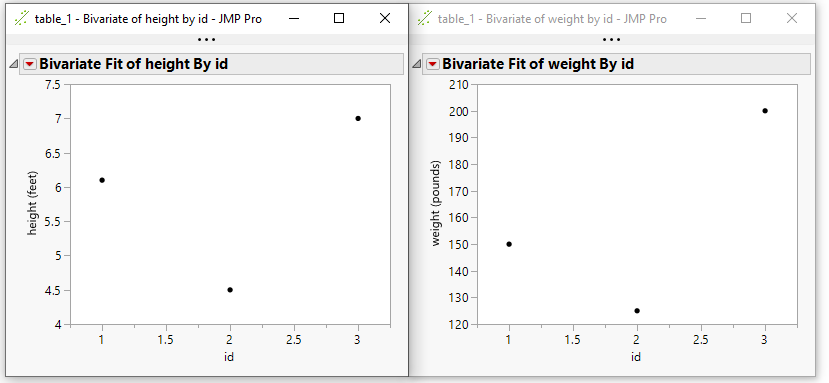

Hi JMP users,
I would like to update column names from a configuration file using JSL and make plots which will have the updated column names in their titles and axes. I am looking for ideas on how I can do this.
I am attaching my code so far and tables. Thanks for the help.
I have attached what I would like the final graph to look like (desired_Bivariate)
-Simon

Re: Update Column Name from Configuration File Using JSL
Here are 2 different approaches to the issue that do not change the actual name of the columns, but accomplishes what you are asking for.  The first one creates Transform columns that have the new names specified for the run of the bivariate.  Those columns only exist for the bivariate execution.
The second example uses the Units Column Property for the different columns in the data table.  The platforms in JMP honor the Units column property, and display it as an addition to the actual column name by placing the Units value in () following the column name.....(i.e. Height(feet) )

// This version of the script takes advantage of the Units
// column property.  It will automatically add (unit value) to
// the display output, without actually changing the columns
// name
