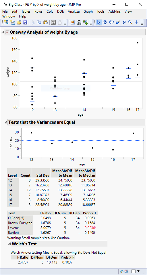

I cannot reproduce the problem you have. Here is :weight by :age (original variables):

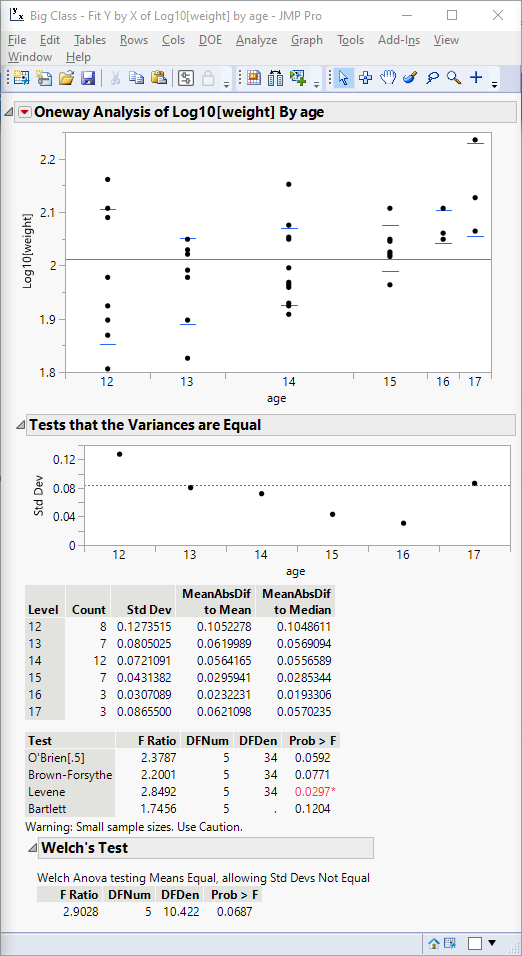

Here is the analysis after creating a new response column with a formula:

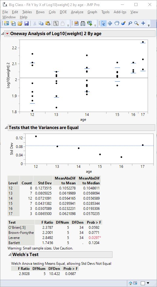

Both the ANOVA and Unequal Variance use the same transformed data. Here is the result using a virtual formula:
Again, both analyses use the transformed response.
