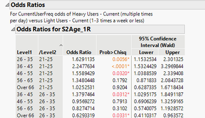

I'm not sure I understand your first question, but if you response variable has multiple levels, you should have multiple parameter estimates table that relate your factors to the different levels.  I believe JMP only provides the odds ratios for a binary response variable.  But if you save the prediction formula from the logistic regression, it will give you the probabilities.  You can then tabulate these for the groups you want to compare and calculate the odds ratios from the probabilities.

Also, can you help me interpretate the figure below. The level1/level2 is throwing me off.
I changed the DV to binary (heavy cannabis users = 1 vs light cannabis user = 0) and those are age ranges (e.g. 26-35year old, and 21-25 year old).
So for the first line, would the right interpretation be that compared to 21-25 years old's, 26-35yo have 1.629 times the odds of being a heavy cannabis user?
