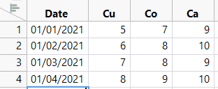

Although I made up some numbers, I think your data looks something like this:

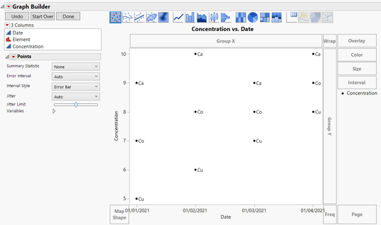

If I am correct, stack your element concentration columns so that your table looks like this:
Now you can follow the help article that you found to create special symbols using the Element column to determine which symbol to use when. Or, turn on the Label feature for the Element column, and label each row of the table. So that your graph can look something like this:
