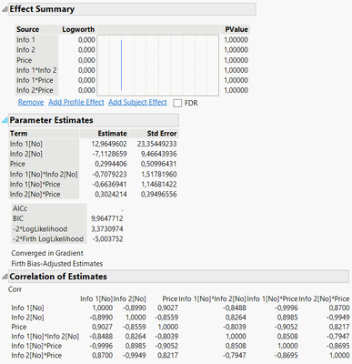

Hi Victor, Yes table 2 is a transpose. Does this study design make sense? Also, I did try to estimate the simulated data and it gave me all zeros. Any thoughts please? Thank you so much for following up on these two questions. Regards.

Can you provide more context and infos ? JMP file and the steps you have done leading you to 0 ?

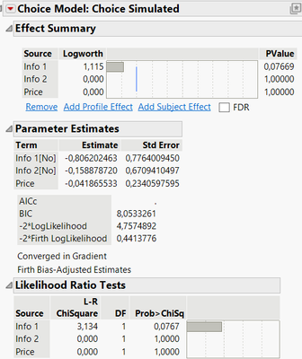

Using your Excel file and the Choice simulated column, I have a "normal" analysis window :
You may encounter "a lot of zeros" for the factors estimates if your response is random binary 0/1 and not influenced by specific factors. Also if you are trying to fit a complex model to a small and simple design, you can obtain zero on logworth, so no significant p-values :
In this case, the correlations between terms in the model are high, preventing the precise estimation of effects and inflating std error. It's becoming almost impossible to evaluate statistical significance in this situation, so p-values are equal to 1 for each term.

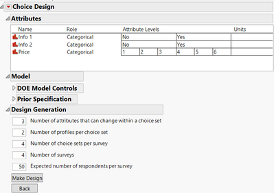

To be sure there is no misunderstanding, the suggestion I made was to create 4-5 different surveys for 4-5 groups of different (random) respondants, not that each respondants answer to multiple surveys.
Here is a snapshot of what I meant in terms of parameters in the Choice design platform :
When creating this design, you'll have 200 independent respondants, distributed in 4 groups of 50 respondants, each group answering a specific survey. Please find attached the design used here as an example, to see the repartition of 200 respondants in 4 groups and the combinations and choices set used in each survey. The platform "Choice" for the analysis takes into account the survey number and respondent ID, so analysis is quite straightforward and simple, and already prepared with the "Choice" script present in the data table generated by the design creation platform.
I hope this response will help you,
