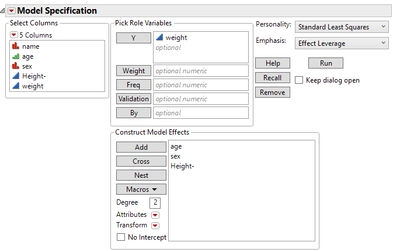

I’m looking to build a copy of this model effects dialog from fit model:
Goal is to build a script that will read in this effects expression from the model script that DOE saves in the table, allow people to tweak the effect expression and then run some analysis using fit model with the new effects expression.
If you run the dialog in below script, you will see that it reads in the effects expression from the model script stored in the table. Puts that in the list box that resembles Fit Model, allows you to tweak it and then when you hit ok it attempts to parse the listbox into a new effects expression and start a custom fit model dialog with that new expression.
The problem/difference is in the special name column: in the original expression it is stored as :name(“Height-”) but when retrieving that expression from the list box, it is stored as “Height-” which becomes a incomplete mathematical operation instead of a column name. So how do I apply the special column name rules to items from this list box? The same applies to crossed and nested terms with the special name column.
