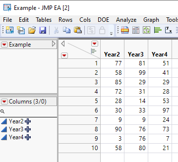

dt = new table( "Example",
	add rows( 10 ),
	New Column( "Year2", formula( Random Integer( 1, 100 ) ) ),
	New Column( "Year3", formula( Random Integer( 1, 100 ) ) ),
	New Column( "Year4", formula( Random Integer( 1, 100 ) ) )

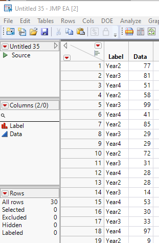

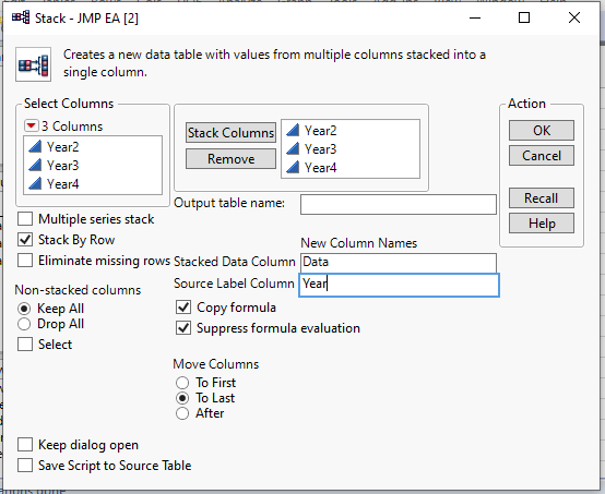

     Tables=>Stack
Fill out the dialog window by placing all of the columns you want to stack into the Stack Columns selection box.

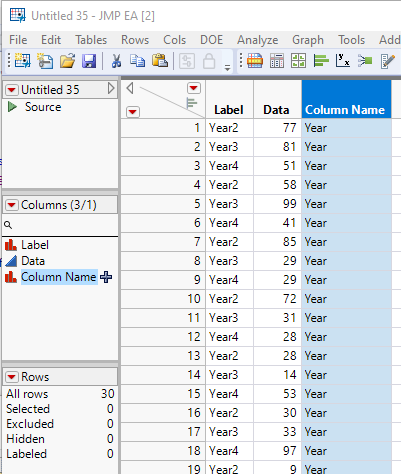

It will create a table that looks like this

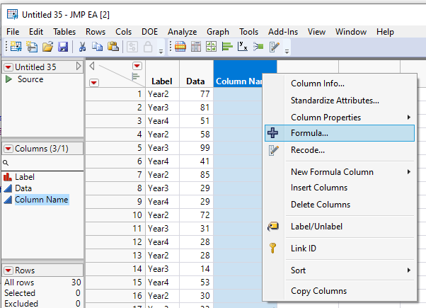

Create a new column in the data table called "Column Name"
Right click on the column header for the Column Name column, and select Formula

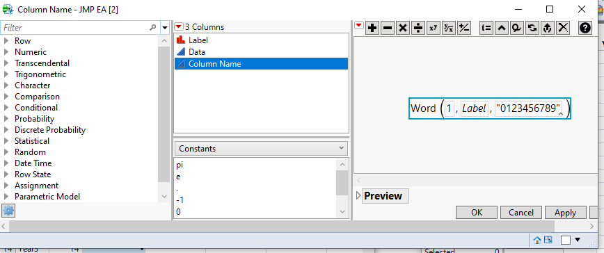

A formula needs to be specified that takes everything before the numbers at the end of the values in the column Label and keeps that as the Column Name value.  So this can be done several ways, depending upon the actual data.  In our example, the formula will find everything before any numbers are seen and take that as the Column Name value.

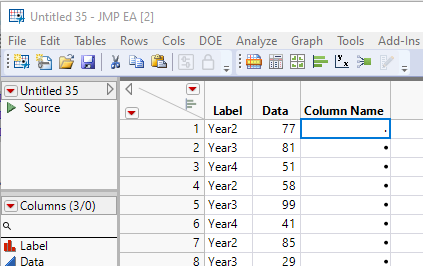

The formula finds the 1st word in the :Label column, stopping whenever it finds any numeric value "0123456789"

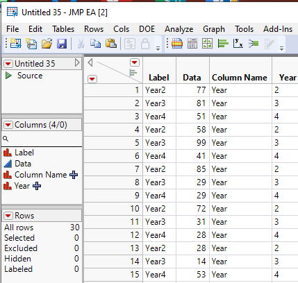

The result is

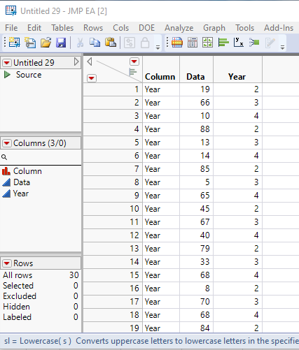

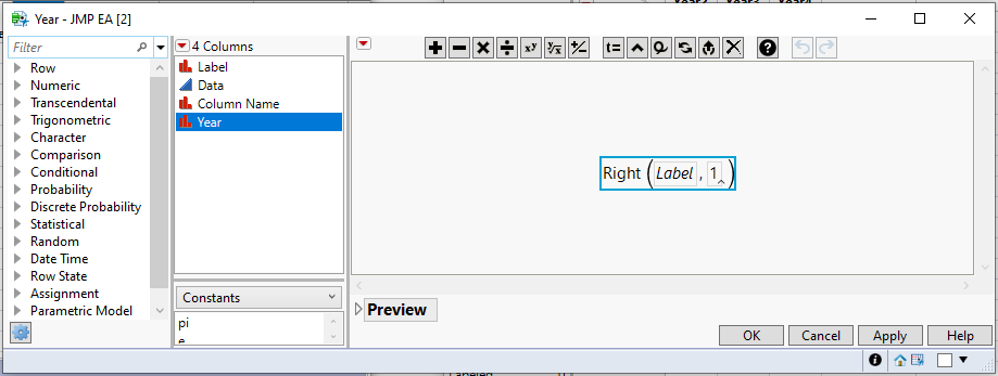

Now create another new column and call it "Year".  In this case, we want to take the last character in the column as the value of year formula is
Which gives you your final data table
