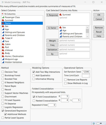

To answer your question, one option could be to use the platform "Model Screening" available in menu "Analyze", "Predictive Modeling".
Once in the "Model Screening" platform, you can deselect methods other than "Generalized Regression" and "Additional Methods" (here done on the Titanic dataset), and specify if you want to include 2 factors interactions or quadratic terms in the model. You can also specify the number of folds for cross-validation and a random seed if you want reproducible results :

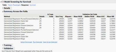

When the analysis is done, you can see the validation results as a summary across the folds. This summary table can help you select the most appropriate model(s) (you can select the model(s) you want to see in more details (or click on "Select Dominant") and then click on "Run Selected" to open the platform of Generalized Regression to have more details about the selected model(s)):

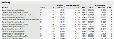

And you can also have a look at individual results by folds (if needed) by opening the menu "Training" and "Validation" (here on "Training", folds identifier can be seen in the last column for each type of model trained):

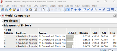

You can compare the R2 values across k folds using the Model Comparison platform in the Analyze > Predictive Modeling menu. Follow these steps:
  1. Create a K Fold column using the Make Validation Column utility and select "Make K Fold Column" (in the bottom left of the dialog window).
  2. Launch Gen Reg and load your KFold column as the Validation role.
  3. Run your regression model (Elastic Net, Lasso, etc.) and make sure that Validation Column is selected as the Validation method.
  4. When you are satisfied with the model, save the Prediction Formula to the data table.
  5. To view the R2 value for each fold, launch Model Comparison from the Analyze > Predictive Modeling menu
  6. Load your saved formula column as the Y and the KFold Validation column as the Group
  7. The resulting report will show you the measures of fit for each Fold in the column:
