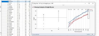

It's been literally years, but I figured out a way to do it without code, and with either Big Class or my actual data set. I use "Fit Y by X" put height in Y, sex in X, then put a Normal Quantile Plot on it. Click and drag in the quantile plot to select the data points that are in the highest quantile regardless of X. (This is trivial with only two genders, but the actual data I was working with had about 7 discrete X values with wildly different Y values.) Then I go back to the data table with just the tallest selected and in the Rows box, right click selected and choose "Data View". It pops up a data table with only the highest quantile values of each X with all columns preserved. Not the most elegant solution, but I got it!
