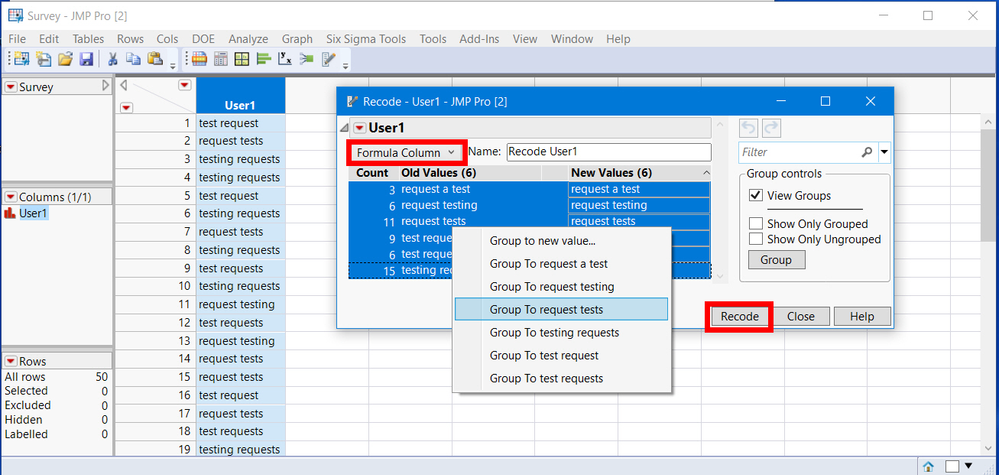

You did not mention what version of JMP you are working on. If JMP12 or higher there is a a column utility called Recode.
The script below creates a dummy table and calls Recode for coulmn User1.
ex= {"request tests", "request a test", "request testing", "test requests", "test request",
"testing requests"};
dt= New Table("Survey", add rows(50), NewColumn("User1", character,
   << set each value(ex[Random integer(1,6)]) ) );
dt << Go To (:User1);
dt << Recode;
The attached screeshot shows the table and the interactive interface. The red box around Formula is a menu option to create a New Column (of values), a Formula (column) or In Place (replace values).  I chose Formula and named the column Recode User1. Next, select all options and right click, then a pop-up menu of options appears. The options are to use one of the numerous phrases, or use a new value. Make your selection and press the Recode button.
Note: If there are multiple goups of answers, you can select the groups by different options, specifying the common term. And when done press recode.
The formula created by this action is
Match( :User1,
	"request a test", "request tests",
	"request testing", "request tests",
	"test request", "request tests",
	"test requests", "request tests",
	"testing requests", "request tests",
	:User1
dt << Recode;
Match( :User1,
	:User1

Re: Text Analysis -- Manually Grouping Similar Phrases
I could be mistaken but it appears to me that the various forms of the phrase to be dealt with are found in the phrase list of Text Explorer. These phrases are not the original character string values in the text data column. I think that this case is unstructured text, not structured character values. So the recode must be done within Text Explorer after parsing and terming.
