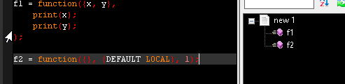

Re: Syntax Highlighting
Here's a Notepad++ syntax highlighter I just threw together using Notepad++'s built-in tool. It obviously won't work as well as the regular JSL Script Editor, but it might do the job.
Here's a preview:
I had to zip the file since the User Community does not allow uploading XML files.
Nice idea @pmroz and thank you @Justin_Chilton! I didn't even think all the time I spend in Notepad++. Now I finally have syntax highlighting for .jmpcust and .def files too!
If I ever find myself with a free evening I will work on a Lexer for Rogue. If I submit something I will let you know.
