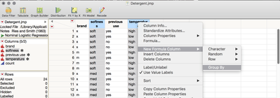

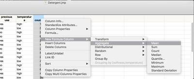

Additionally, in JMP 12 and on, with Instant Formulas in the data table you can select those columns in the table, right-click one of their headers, select New Formula Column > Group By.
Then, select the count column, right-click the header, select New Formula Column > Aggregate > Mean
This will design the formula for you automatically; very friendly for your new users.
