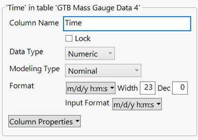

Unfortunately, that is not working for this script. The original script was not made by me, although I assume this is the culprit.
Column( SqlQry1, "DateTime" ) << data type( "Numeric" );
SqlQry1 << New Column( "Time", formula( Round( :DateTime, 0 ) ) );
Column( SqlQry1, "Time" ) << Format( "m/d/y h:m:s" ) << delete formula;
//Column( SqlQry1, "Time")  << Modeling Type( "Nominal");
SqlQry1 << delete column( "DateTime" );
dt0 = SqlQry1 << split( split by( :TagName ), Split( :vValue ), group( :Time ) );
Close( SqlQry1, no save );
Daryl Hurwitz

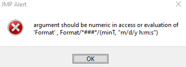

Re: Summarize function Date
I am getting this error...
Which to me doesn't make sense, in that the column was created utilizing the previous script as a numeric time column.
The data is being pulled from an SQL server.

txnelson
place a Num() function around the minT and see what happens. I agree, minT should be numeric
When you move your cursor over  minT what value is displayed?
Jim

txnelson
Can you please supply more of your script. Preferably from the Summarize to the point where you are doing the
Show( Format( Num( minT ), "m/d/y h:m:s" ) )
Jim
dhurw
Level II
Here is from when the time column was created in a data table to the calling of show()

txnelson
I should have realized this earlier.  Because the Summarize() has a by group, the values of minT and maxT are matrices.  If you change the Show() line to
Show( Format( minT[1], "m/d/y h:m:s" ), Format( maxT[1], "m/d/y h:m:s" ) );
you should see the min and max times for the first Part Number
