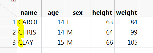

Is the column a character column? In the message there is no subscript on "a" which might mean it is a list rather than an element of the list.
dt = Open( "$sample_data/big class.jmp" );
letters = {"B", "C"};
dt << selectWhere( Starts With( dt:name, letters[2] ) );
dt << subset( selected rows( 1 ) );
Names starting with CNames starting with C
