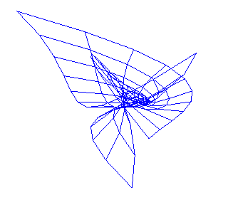

kind of, probably, yes.
JMP uses Open GL to display rotatable 3D objects
This is a fun example from the scripting index.
Note: In the scripting index, search for "Open GL" to find objects and functions that might be handy
Names Default To Here( 1 );
gridsize = 10;
npoints = 32;
points = J( npoints, 3, 0 );
For( i = 0, i < npoints, i++,
	points[i, 1] = Random Uniform() - .5;
	points[i, 2] = Random Uniform() - .5;
	points[i, 3] = Random Uniform() - .5;
surface = Scene Display List();
surface << Enable( MAP2_VERTEX_3 );
surface << Enable( Auto_Normal );
surface << MapGrid2( gridsize, 0, 1, gridsize, 0, 1 );
surface << color( 0, 0, 1 );
surface << Map2(
	MAP2_VERTEX_3, 0, 1, 3, 4, 0, 1, 12, 4, points
surface << EvalMesh2(
	LINE, 0, gridsize, 0, gridsize
sb = Scene Box( 500, 400 );
sb << Ortho( -.75, .75, -.75, .75, -1, 1 );
sb << ArcBall( surface, 1 );
New Window( "Example", sb );
