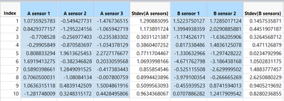

In manufacturing, is common to extract sensor data in the following form, where A and B correspond to similar devices (known as assets).
In this format, the user needs to create a combined formula for each parent group. For example:
(Input: Sensor data table needs specific columns per parent group)
When handling several assets, this becomes cumbersome, so a better way is to stack the data per group asset.

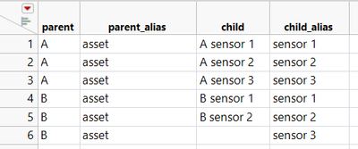

To do this programmatically, we need contextual data containing the hierarchy. For example:
(Input: asset hierarchy)
In JSL, how can you move from the sensor data and hierarchy (inputs) to the asset table (desired output)?

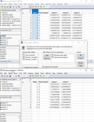

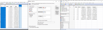

The most straightforward operation I found was by automating these data steps.
1) Stack
 2) Split
3) Concatenate

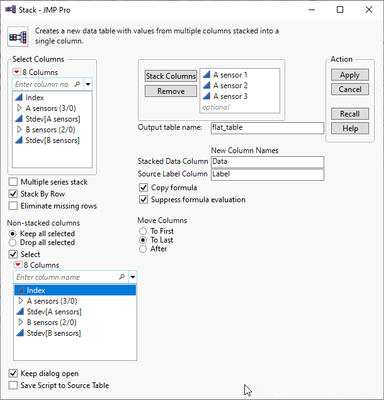

Maybe something like this:
Names Default To Here( 1 );
//dt=open("input_example.jmp");
//Stack data table
Data Table( "input_example.jmp" ) << Stack(
	columns( Column Group( "A sensors" ), Column Group( "B sensors" ) ),
	Source Label Column( "Label" ),
	Stacked Data Column( "Data" ),
	Output Table( "Stacked Data" )

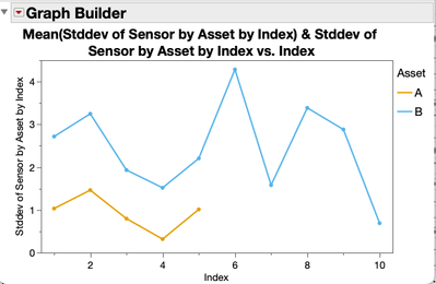

I used Worflow Builder in JMP 17 to "write" this script.
The key is using the "by" arguments in the formula.
This lets me completly stack the data to have the complete hierarcy with the data all in one column.
Then I get the stddev of the whole column of data by asset and by index. That lets me make this graph:

Re: Stacking in JSL indexed columns by group (sensor data and assets)

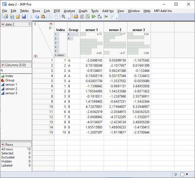

One option is to go pure JSL route if you do have the hierarchy table. Code might be able to explain itself:
Names Default To Here(1);
dt_hier = Open("$DOWNLOADS/hierarchy_example.jmp");
dt_input = Open("$DOWNLOADS/input_example.jmp");
// some assumptions:
	// both parents will have same amount of columns
new_col = dt_hier << New Column("Data Cols", Character, Nominal, << Set Each Value(
	Regex(:Child column, "sensor \d")
data_cols = Associative Array(new_col) << get keys;
dt_hier << Delete Column(new_col);
dt_collector = New Table("data",
	New Column("Index", Numeric, Ordinal),
	New Column("Group", Character, Nominal)
For Each({data_col}, data_cols,
	dt_collector << New Column(data_col, Numeric, Continuous)
Summarize(dt_hier, parents = by(:Parent));
For Each({parent}, parents,
	parent_rows = Loc(dt_hier[0, "Parent"], parent);
	parent_cols = dt_hier[parent_rows, "Child column"];
	parent_data = dt_input[0, parent_cols];
	non_missing_idx = Loc(parent_data);
	row_count =  N Items(non_missing_idx) / n cols(parent_data);
	parent_data_clean = Shape(parent_data[non_missing_idx], row_count);
	first_row = N Rows(dt_collector) + 1;
	last_row = first_row + row_count - 1;
	dt_collector << Add Rows(row_count);
	dt_collector[Index(first_row, last_row), "Index"] = Index(1, row_count)`;
	dt_collector[Index(first_row, last_row), "Group"] = Repeat({parent}, row_count);
	dt_collector[Index(first_row, last_row), data_cols] = parent_data_clean
Quite a few assumptions made here and no proper error handling
-Jarmo
The hierarchy can be already in the table as metadata (column property).
I have updated the example so you have parent (group), parent alias, child, and child alias embedded in the table.
I think the most intuitive approach will be to stack the table by an asset (subset), split data by label, and then concatenate tables together.

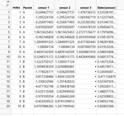

I have also simplified the requirements (no more empty values) and found a solution (stack, split, concat) that needs to be done iteratively (per asset). The hierarchy data is now embedded in the main table (progress can be found in the input_example).
FN
FN
Level VI
1) Stack
 2) Split
3) Concatenate
