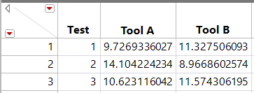

Scenario1:
I want to Split "Random metric value", Split by Tool A&B, Group by only "Test", and hope the "random metric value" from different iterations can be averaged for the same "Test".
Here is what I got:

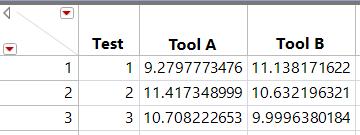

Scenario 2:
But when I do manual averaging (Summary-Mean(Random Metric Value) then split by tool A&B), the results are different:
Above should be the right results.
But my question is: what is happening when I do SPLIT in the 1st scenario without cast "Iteration" column anywhere?

Re: Split function: what is happening when one column is not added into "Group"
The split does not do any calculations.  In your first case, it is selecting the last iteration value for each test and placing that into the appropriate Tool A or Tool B.
Jim
