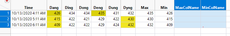

Hi,
Pls help me on generating a new column formula for calling out the Column Names which has the min and max number in the same row.
From this
to this

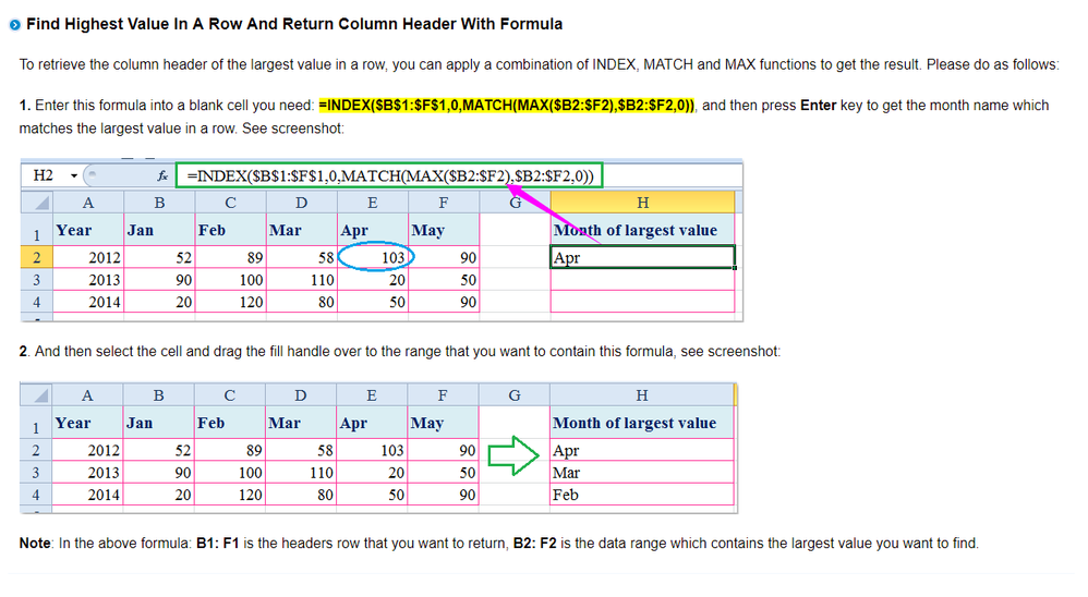

I tried it but not working. I found it in Excel formula, but not sure how to convert it to Jmp. As per in this screenshot
=INDEX($B$1:$F$1,0,MATCH(MAX($B2:$F2),$B2:$F2,0))

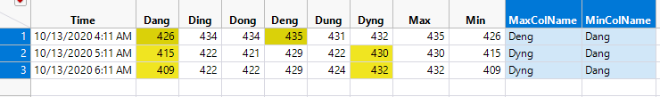

Hi MS SUPER USER,
I figure it out to get it work. Thanks. Jmp14.
It looks like we can only make it work when it's treated as local columns. Is there a way to name them by the original column name, instead of column numbering? The reason I am asking, if someone added/appended some columns in the data table, the column numbering may not work properly.
