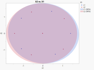

There might be an option for the case you describe : when clicking on the red triangle in the "Custom Design" platform, you can change the value of the Sphere Radius : Custom Design Options (jmp.com)
In your case (with 2 continuous factors and 1 categorical factor), when setting the sphere radius to 1,414 (the value for rotatable CCD with 2 continuous factors), I get a rotatable design regarding the two continuous factors :
And here is the script to create such design :

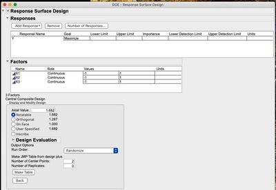

statman
Re: Specifying axial value as rotatable in custom design
Welcome to the community.  Have you tried DOE>Classical>Response Surface
For categorical, there are options.
https://www.jmp.com/support/help/en/17.0/?os=mac&source=application#page/jmp/response-surface-design...
