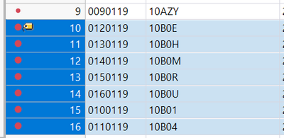

Hi everyone,
I have question... how can I sort data like SAP it does?
1. SAP ... batch numbers on the rise
2. JMP ... letters in priority
Thank you in advance!

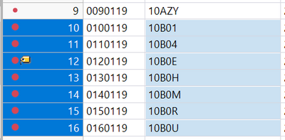

Re: Sorting data By JMP
or specify the way you want to sort the elements in that column in the column properties "Value Ordering". There you can choose to order by row, numeric, alphabetic or completely custom. This will be saved to the column property and applied when using sort.
Use the Sort platform found under the Tables menu.
You were right!!!
