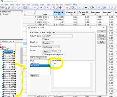

Hi JMP Community,
Is there a way to sort the columns by the column property?
I have a data table where the column contains the property "Test Number" (see below).
I want to sort all the columns in the column group "Tests" by the column property "Test Number"
I have attached the data table below. Any suggestions?
Thanks, Jackie!
