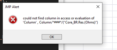

Some glitch in the script. Script works 70% of times and 30% of times, I get error -- "Could not find column in access ........"
Hello guys,
I have a part of a script which some time does not work and throw an error -- " could not find column in access or evaluation of 'Column' , Column/*###*/("Core_BR.Res.(Ohms)") "
In the script, I am just renaming columns and in fact, I thought it is related to the size of the table so I have included "Wait(0)" after each column rename command. But no good luck.
Script is like this --

And the error I get is ---
The thing is, I am not getting this error evrey time. Script works fine 7/10 times but throw error otherwise.
If I active this table (by clicking it) and then run the script, it works 100%. Which means somehow my "dt= Data table (....)" is not refreshing oe recalling  the table or somthing like that !
Any help.
Thanks, Hari

Re: Some glitch in the script. Script works 70% of times and 30% of times, I get error -- "Could not find column in access ........"
Try changing all of your name setting statements from this structure:
Column( "Core_BR.Res.(Ohms)" ) << Set Name("Core_BR");
to
Column( dt, "Core_BR.Res.(Ohms)" ) << Set Name("Core_BR");
It will force JMP to go to the data table referenced by "dt"
Working fine after this change. Hopefully will not face the issue again. Many thanks "Nelson".
