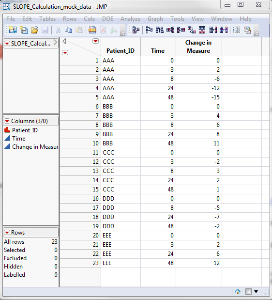

I know that the topic of linear slope calculation has been discussed before but I could not find an efficient way to create a tabulated output of Slopes for a set of Cases (i.e. Patients) for which I have varying numbers of obervations as a function of time.
Here is a screen shot of the data (mock; the actual file is attached):
Mock data for SLOPE calculationMock data for SLOPE calculation

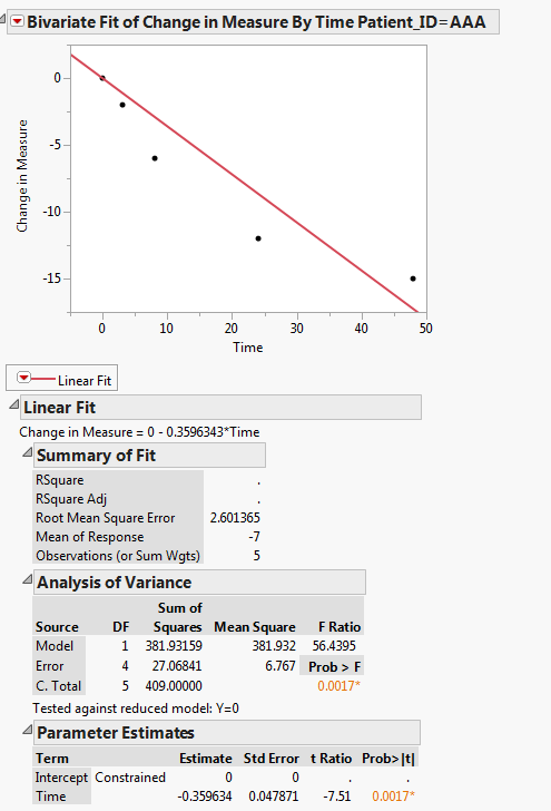

Following the advice of previous discussions in this board, I used the Fit Y by X (Change in Measure by Time) using Patient_ID as By variable, and plotting a linear fit with intercept constrains to 0:
Ouput: 5 analyses identical to the one below:
Where I'm stuck is how to collect the Estimate of the Slope into a new table that would look like:
Patient_IDSlope
AAAm1
BBBm2
CCCm3
DDDm4
EEEm5
Any suggestion would be welcome: I'm not attached to the original data format or the analysis method.

You discovered the By role group the data for separate regression analysis. (I hope that you know to press and hold the Ctrl key before clicking the red triangle and selecting the Fit Line command!) Now right-click on the Parameter Estimates table and select Make Combined Data Table.
