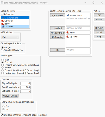

However, as you have a sample/part ID and you want to assess reproducibility of the measurements with two methods, I think the platform "Measurement Systems Analysis (jmp.com)" under "Analyze", "Quality and Process" might also be informative for you. You can specify your sample ID, method (in my example it's "Operator" in X, Grouping), and measurement result :

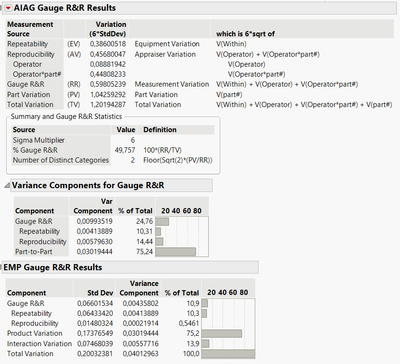

When the analysis is launched, you can then click on the red triangle from "Measurement Systems Analysis for" (your response), and have a look at the results from AIAG Gauge results R&R or EMP Gauge R&R. This will help you determine the repartition of variance measurements between the method (reproducibility), the part-to-part variation, and the repeatability (since you have 5 repetitions for each sample and method) :
This may not be rigourously what you expect to do, a statistical testing for variances, but it might provide you a more global and informative overview on variance repartition of your measurements between repeatability, reproducibility and part-to-part variation.
