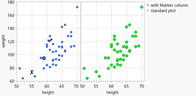

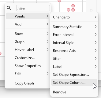

while waiting for new Column Property: Value Markers , I tried to use a Shape Column in Graph builder for better/consistent marker control:
Not bad ...

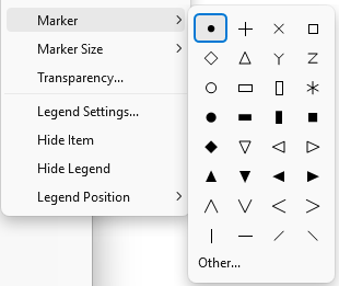

but I need more details:  How can I specify one of the default markers?
nice trick: empty entries are displayed with a "dot"
but: Marker Drawing Mode - Outlined doesn't work. why?

Workaround to get the outlines: add another point plot with hollow markers
