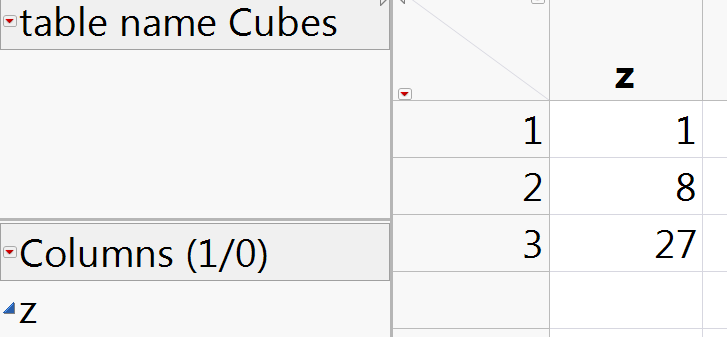

use the data table object returned by the NewTable function to tell which table a variable is in. The table's name is not used for the scoping of the variables. The third assignment uses all three tables. I named everything uniquely, but that isn't required with scoping.  dt3: , for example, sets the scope, or the places to look, for the variable that follows, z, in this example.
dt1 = New Table( "table name A", New Column( "x", values( [1 2 3] ) ) );
dt2 = New Table( "table name Squares", New Column( "y" ), addrows( 3 ) );
dt3 = New Table( "table name Cubes", New Column( "z" ), addrows( 3 ) );
For( i = 1, i <= N Rows( dt1 ), i++,
    dt2:y[i] = dt1:x[i] ^ 2;
    dt3:z[i] = dt1:x[i] * dt2:y[i];
small table of Cubessmall table of Cubes
