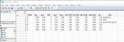

im working with a set of data in a process that i am expecting to repeat many many times, as such i'm trying to automate the set up as best i can. For the moment i'm working on some data presentation, ansd i need your help in making a graph's axis titles variable depending on the content of cells.
as an example i have the data below :
from this data i want to plot a graph showing "Res" for each "Col A" value, as well as a series of reference lines showing "Ref" (and its boundary conditions "+/-uref" and "rob" and its boundary conditions "+/- urob".

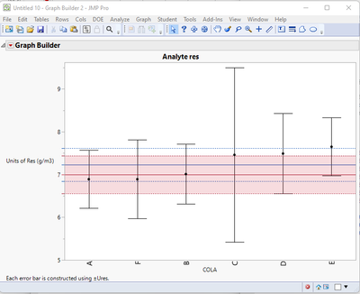

Which works fine and is flexible enough to be able to modify the reference lines in the graph according to the cell values as required.
Now, what i'd like is also for the titles to be able to do the same thing as the reference lines. So ideally i could add an initial column in my jmp table, which we will call "info" which has the information on the studied analyte (name, units used for measurement, etc...) and i'd like for the graph's title (and axes) to pull the information out from these cells (like the reference lines are currently doing) and use this info in the text.
For example, if in my "info" column i have "Zr4+" i'd like the final graph to go and look for this cell and use it to label itself or one of its axes.Such that i can then change the cell to "Br7-" and the next time i run the script, the new graph will be labelled with "Br7-".
Is it possible to do this?
bonus points if the variable can be inserted in a longer text, eg the y axis is "Zr 4+ (mg/l)" and then changes to "Br7- (mg/l)"

I added a new Info column to your data table
And modified your script to use it to get the values for the labels.  I also modified your script to used a more direct way to add the reference lines to the chart.

gbr[TextEditBox(1)] << set text(column(dt,"info")[1]);
gbr[TextEditBox(3)] << set text(column(dt,"info")[2]);
gbr[TextEditBox(4)] << set text(column(dt,"info")[3]);

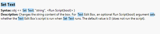

The specification for Set Text, as found in the Scripting Index is:
So basically, what has to be provided is a "String".  In JSL, pretty much anything can be put into a string.  From the example in the sample script
The value from the first row of the "info" column is being sent to the TextEditBox(), and since the column "Indo" has a Modeling Type of Character, the values in each cell is a "String".
JSL allows the building of Strings in many different ways.  I strongly suggest that you take the time to read the Scripting Guide that can be found in the JMP Documentation Library, available under the Help pull down menu.
But for simple illustration, if you want to have "Graph 5 Analysis Res it could simply be stated as
gbr[TextEditBox(1)] << set text( "Graph 5 " || column(dt,"info")[1]);
Where the string passed to the TextEdibox()  is a String made from concatenating the string "Graph 5 " with the string from the cell from the first row of the column Info.
