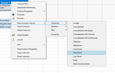

This can be done in many different ways. Below are fairly interactive methods

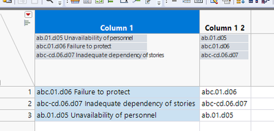

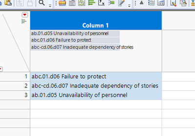

Starting table

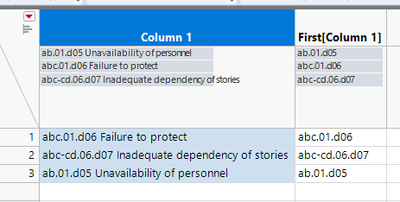

Quick formula:
Right click on your column and take first word

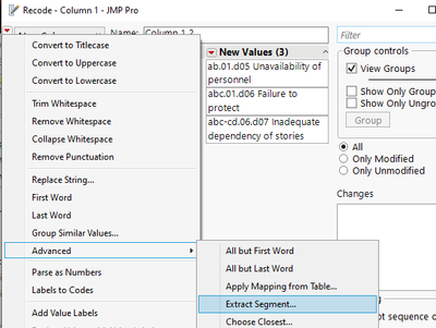

Using recode:

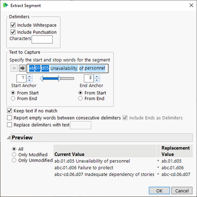

Select your column and go to Cols/Recode, find extract segment (could also use First word)
Use slider to pick correct parts and check from bottom that you are getting correct result
and you will end up with column like

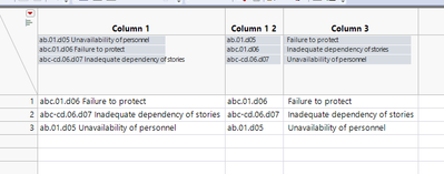

Getting the text:
You can then repeat the recode process to create other column or create a column which substitute the newly created values from original column with missing string (might want to add extra space there or wrap it with Trim Whitespace() function)
Substitute(:Column 1, :Column 1 2, "")
-Jarmo

txnelson
Re: Separating a string value
Select the column in question
Then go to
     Cols=>Utilities=>Text to Columns
It will create new columns based upon the selected delimiter.  In your case, us a space to get what you want.
Jim
