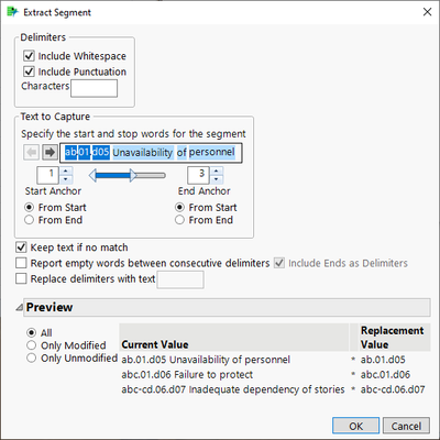

Hi - I need to separate the above values into separate columns. One column will contain the numerical values and the other will contain the text so for example for the first row, I want abc.01.d06 in the first column and Failure to protect in the second column. Can someone please help?

This can be done in many different ways. Below are fairly interactive methods
Starting table
Quick formula:
Right click on your column and take first word
Using recode:
Select your column and go to Cols/Recode, find extract segment (could also use First word)
Use slider to pick correct parts and check from bottom that you are getting correct result
and you will end up with column like
Getting the text:
You can then repeat the recode process to create other column or create a column which substitute the newly created values from original column with missing string (might want to add extra space there or wrap it with Trim Whitespace() function)
Substitute(:Column 1, :Column 1 2, "")
-Jarmo

txnelson
Re: Separating a string value
Select the column in question
Then go to
     Cols=>Utilities=>Text to Columns
It will create new columns based upon the selected delimiter.  In your case, us a space to get what you want.
Jim

dn610
Level III
Thank you!
