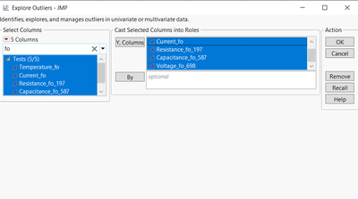

Hi,
I need to search the column names which has the string "fo" in it and select those column in the Y,Columns.
How do I include this in JSL?
Any help on this would be very much appreciated

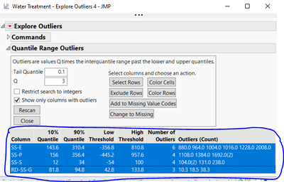

Happy Wednesday @jthi ,
I was attempting to add another contain statement to filter all the columns containing the string "SE" but it didn't seem to work as expected.
I added Contains(colList[i], "SE") in the if loop
Any thoughts?
Names Default To Here(1);
dt = Open("$SAMPLE_DATA/Water Treatment.jmp");
colList = dt << Get Column Names("String");
filteredCols = {};
For(i = 1, i <= N Items(colList), i++,
If(Contains(colList[i], "SS"),
Contains(colList[i], "SE"),
Insert Into(filteredCols, colList[i]))
obj = dt <<
Explore Outliers(
Y((Eval(filteredCols) )));
obj << Tail Quantile( 0.1 );
obj << Quantile Range Outliers;
obj<< Select Rows(All);

This needs to be an OR clause
If(Contains(colList[i], "SS") |
