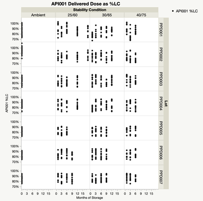

You can see that I was trying to reproduce the "Ambient" data as t=0 for each of the other conditions (25/60, 30/65 and 40/75). To that end, the script works brilliantly. However, it doesn't accept new data entered into the data table (for example more lots) and is not flexible with respect to "Months of Storage" shown. The script is using a predefined list to display "Months of Storage" but this might be different or change in the future as new data is entered.
How can I make the script more flexible so that all data in the data table is evaluated in the future when new data becomes available?
Thanks in advance!

Hello George,
Yes, that is correct. Users are going to update the data table whenever new data is available. New data may have entries for Months of Storage or Storage Condition or Lot that have not been used before.
For example, we may anticipate test results for 0, 1, 3, 6 months, etc. but may find that additional testing between testing intervals is necessary (i.e., 4 months). So we need the list that is storing values for Months of Storage to use whatever is entered into that column. We can't anticipate every entry and we do not want to inadvertently exclude data in the report. The same is true for Storage Condition or Lot.
The Storage Condition "Ambient" and Months of Storage "0" is a special case. Here we are trying to replicate the "Ambient" results as each Storage Condition that is NOT Ambient and assign the test results to "0" Months of Storage.

Hi, this may work for you:
  • It assumes that the original data table--the first one created--from the previous script is current, with derivative reports and graphs closed (to allow sorting in-place)
  • The "Ambient" category remains present, but isn't shown.
  • When additional data is available, just re-run the script.
Cheers,
Brady
