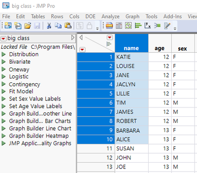

My previous response was intended to show you how to access the item in the clip board.  I assumed from there you would be able to build the list you needed.  Here is a more complete example that takes each item found in the clip board, and adds them to the list called "theList".
So if you copy into the clip board the following
and run the script
Names Default To Here( 1 );
myClipboard = Get Clipboard();
theList ={};
i=1;
while( word(i,myClipboard,"\!t\!n\!r" ) != "",
	insert into(theList,word(i,myClipboard,"\!t\!n\!r" ));
	i++;
show(theList);
It creates the JMP list "theList"
theList = {"KATIE", "LOUISE", "JANE", "JACLYN", "LILLIE", "TIM", "JAMES", "ROBERT", "BARBARA", "ALICE"};
Jim
