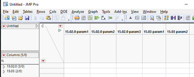

Names Default To Here(1);
// this solution requires JMP16
dtAggWide = New Table("Untitled",
	Add Rows(0),
	New Column("15.02.0 param1", Numeric, "Continuous", Format("Best", 12), Set Values([])),
	New Column("15.02.0 param2", Numeric, "Continuous", Format("Best", 12), Set Values([])),
	New Column("15.02.0 param3", Numeric, "Continuous", Format("Best", 12), Set Values([])),
	New Column("15.03 param1", Numeric, "Continuous", Format("Best", 12), Set Values([])),
	New Column("15.03 param2", Numeric, "Continuous", Format("Best", 12), Set Values([]))
col_list = dtAggWide << Get Column Names("String");
// first get the column group names and columns
// in this solution case we use associative array aa_groups = Associative Array(); For Each({col_name}, col_list, col_group = Word(1, col_name, " "); If(!Contains(aa_groups, col_group), aa_groups[col_group] = {}; ); Insert Into(aa_groups[col_group], col_name) ); Show(aa_groups); For Each({{key, value}}, aa_groups, dtAggWide << Group Columns(key, value); );
-Jarmo

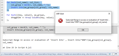

OK, I think I see what you mean, I was confused why you were creating a new dt, but looks like just for the example.
your second set of code doesn't seem to work for me, but the first set did. Any idea what this error means?
//Group the Cols by name of RecipeStepId
col_list = dtAggWIDE << Get Column Names("String");
Show(aa_groups);
jthi
Re: Script to loop thru and group columns by name, dynamically
I think that error means that you don't have a key in associative array. If you tried the second code, does your code have this line:
aa_groups = Associative Array(RecipeStepIndex, Repeat({{}}, N Items(RecipeStepIndex)));
it is used to initialize aa_groups. Also if the RecipeStepIndex do not match with col_group = Word(1, col_name, " "); you will get that error. You might have to add some extra handling for cases like that (add group which will collect all the missing columns or only add columns which are found).
This should skip columns which do not have matching group.
		aa_groups[col_group] = Eval List({col_name});
		Insert Into(aa_groups[col_group], col_name);
-Jarmo

col_list = dtAggWIDE << Get Column Names("String"); //get the col list
For Each({{key, value}}, aa_groups,					//perform the grouping
V2=
//**split Aggregate Data from TALL to WIDE, grouping WIDE columns by StepID
dt = current data table();
//Build and prefill an Array of names of the RecipeStepId
Summarize( dt, RecipeStepIndex = by( :RecipeStepId) );//get list of unique RecipeStepID's
//split the table TALL to WIDE
dt << Split(
       Split By( :RecipeStepId, :ParameterName, :AggregateFunction ),
       Split( :Value ),
       Group( :Recipe, :ProcessTime, :Tool, :Chamber, :Lot, :WaferScribe ),
       Output Table( "AggWide" ),
       Remaining Columns( Drop All ),
       Sort by Column Property,
       dt << sort( by( :Recipe, :Tool, :Chamber, :Lot, :WaferScribe ))

Nice script!  I tweaked it a bit to group all data columns with the matching first 4 characters in the column title.  The data I get is named in that way and this makes it much easier to look at like data kinds.
dt = Current Data Table();
col_list = dt << Get Column Names("String");
// first get the column group names and columns// in this solution case we use associative array
	col_group = Substr( col_name, 1, 4 );
Show(aa_groups);
	dt << Group Columns(key, value);
