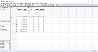

Hi. Could you please help me to write a script that takes the original table and make a new table out of it? Original table has two lines per each sample temperature measurement. In the output table we use only one row per each sample and calculate number of the days between the two measurements and the temperature delta.

Could you provide the example data as JMP table so we don't have to create it from the image (formats can have big impact on the script)

Hi Jarmo. Thanks for your support. Please find attached.

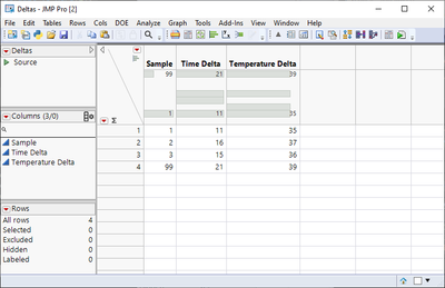

You can use following formulas
:Temperature - (Col Moving Average(:Temperature, 1, 1, 0, :Sample) * 2 - :Temperature)
and
(:Date - (Col Moving Average(:Date, 1, 1, 0, :Sample) * 2 - :Date)) / In Days(1)
to calculate the deltas.
Then either create new table without the 0 rows (don't include formulas in that table) or remove formulas and delete those 0 rows.
I think this script should work for JMP14 (I cannot test it as I don't have access to that)
Names Default To Here(1);
dt = Open("$DOWNLOADS/source table.jmp");
dt << New Column("Time Delta", Numeric, "Continuous", Formula(
	- :Temperature)
dt << New Column("Temperature Delta", Numeric, "Continuous", Formula(
	In Days(1)
dt << Select Where(:Temperature Delta == 0) << Invert Row Selection;
dt_subset = dt << Subset(
	Copy formula(0),
	Selected Rows(1),
	Columns({"Sample", "Time Delta", "Temperature Delta"}),
	Output Table("Deltas")
dt << Clear Select;
-Jarmo
Re: Script for table processing JMP14
Kiitos Jarmo. Let me try it.
Jarmo, thanks a lot for your solution. It is working.

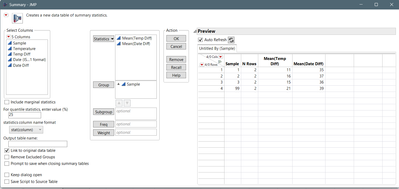

You could add two formula columns that calculate the maximum - minimum for each sample (temperature and date):
Or run below script to get your example table with formula columns.

And then a quick summary will give you the table you were after:
