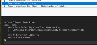

I noticed that saving a script to the data table may not capture the last bit(s) of analysis.  For example, when I execute >Distribution (empirical) on a subset of data I have the option to save Probability Scores, like in the included screenshot.  That last bit is not captured by the saved script.  Is there a way to include it?

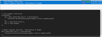

It will get saved to Enhanced Log (or workflow builder most likely). I think you have to capture it from there and then make slight modifications to add it to your table script
I this case it could be enough if you take this script
and remove unnecessary parts. From
// Save Columns: Prob Scores
Local({obj},
	obj = Data Table("Big Class") << Distribution(
		Continuous Distribution(Column(:height), Process Capability(0))
	obj << Save("Prob Scores");
	obj << Close Window;
to
	obj = Distribution(

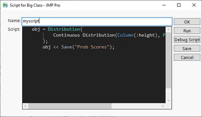

You might also want to drop the table name. You can save this as table script
obj = Distribution(
But depending on what you are doing I would suggest you also check out workflow builder
-Jarmo
