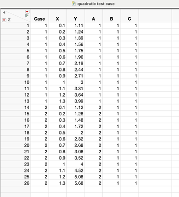

Friends, I have created a simple X-Y data table.  It includes 2 cases each with its own X-Y series.  I have used the Fit Y by X option in jmp to create polynomial best fit equations that are reported in a GUI.   What I need to do is output the fit parameters by case to a data table that I can them merge with the original data table.  Hard to do?  How might I go about this.  Thanks. AndyB

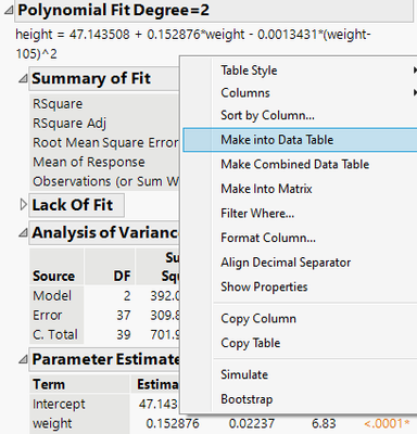

Saving the formula could work
Or right click on the parameter estimates table and make it into a datatable
You can then do what you wish with that resulting data table

Andy:
I noticed that you are fitting by Case #. When you launch the fit-y-dy-x dialog, include the Case column in the By role. Then when you fit the polynomial, be sure to hold down the CTRL key to broadcast to all the Cases. Then, right click on the first Parameter Estimate table as @jthi showed, but click on Make Into Combined Data Table. You will have to split the resulting table by the Term column.

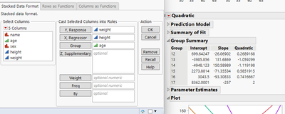

Another approach would be to use the Fit Curve platform, fit a Quadratic, and export the parameters from the Group Summary table. The example below uses the Big Class sample data table.

Jed_Campbell this is perfect !!!!!!    Thank you sooooooo much!  SImple and elegant.  Sincerely, Andy
